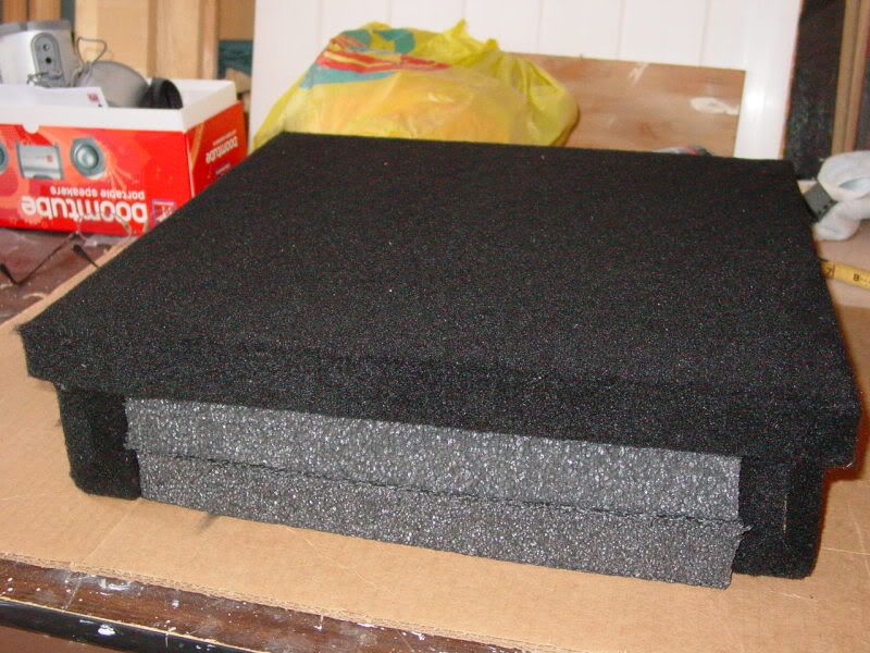

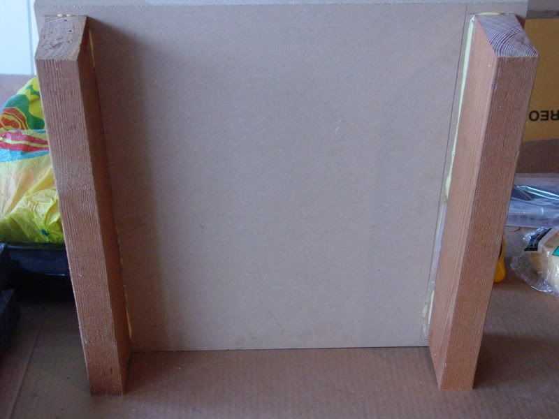

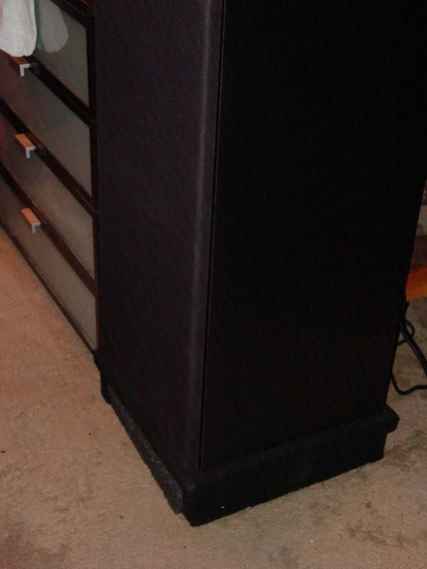

Built and placed mine in the room today.
Will check with the SMS-1 later in the week.
Football is starting and too many doctors to see tomorrow.
I used some packing foam that came from my mechanic instead of the Polyfill from Walmart. Used 2 pieces, but did not glue them in place. They are being held in strictly from the snug fit. Not sure if I am better off this way or by having a single piece of foam glued in place, or should I glue everything???? Somehow, the foam is angled. I may take a very sharp knife and do some final trimming.
You can see how the foam didn't come out completely even.

Look's real nice Animo ~ I'll bet putting that Beast of A sub on there was fun .

Looks good But I think you should have used one of these to support that monster

Came out real nice Animo'. No need to worry about gluing the 2 pieces together, as IMO, it looks like they're not going anywhere anyway. Also, if it Sounds good as is, I'd say you're set. I was going to build one very similar to that today but I didn't get around to it. I'm doing the same thing as you did; using wood glue with a couple 2x3's to adhere the MDF piece to them. Then I'll use some left over foam to go under for when my 2nd PA-120 arrives (hopefully by late this week).
