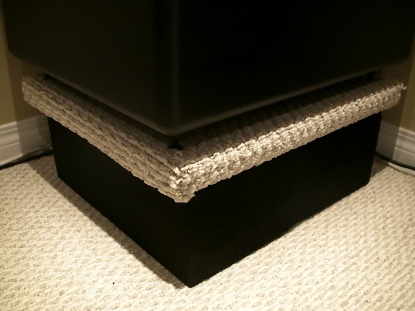

Well, with my second A2-300 on the way, I took the time to build a second riser. Though I wanted to make it similar to my first riser, I didn't think I was going to produce it exactly the same, to the quarter-inch! I worked out well, and looks exactly the same.
I didn't have any more of that 1 1/8" butcher block to make the base out of, so I found some 3/4" shelving planks, 8" wide, and I glued and screwed 4 pieces together (2 running width-wise side-by-side, and 2 running depth-wise side-by-side, and then these 2 were stacked). Once this was done, I ended up with an 18" by 20" solid base.
I wrapped this in the same carpet as my basement carpet, and then attached the foam corners that my original A2-300 came packed in. These were first foam-glued to each-other, and then screwed into the base. The gaps were filled with 2" ridged foam insulation, and then the 'void' in the middle was filled with Elemental Designs 2" Acoustic Pyramid foam. The entire 'leg' section was wrapped in black felt to hide the imperfections, and it was done.
It's solid and strong. I even stepped onto it for a minute, and I'm close to 200lbs. No signs of not being able to handle it. After that, the kids were no problem:
Here is a picture of my original riser:
Congratulations. The riser looks excellent and the kids look beautiful.
Make sure the kids understand that they should not put their hands into the ports of the speakers and subwoofers. Little kids are known to put little items such as small cars, food, etc. in the ports.
Yea, every once in a while I see my youngest reaching into the port, and the A2-300 has the most 'inviting' port for little kids I have seen! Luckily when I cracked open the sub to fill it with Poly Fill last week, there was nothing inside, even after having it for 8 or so months.
