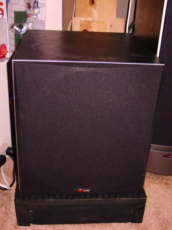

I started making my sub riser today. I have a little surprise for you guys, you'll just have to wait until I'm done to see it. The base platform is done, and I have all the materials.
I found 3" thick high-density foam at the fabric store. It was the most expensive thing so far. It was right around $14 so I'm hoping it's worth it!
The automotive carpet was hard to track down. I called 3 different auto parts stores and went to the biggest fabric store with no luck. Turns out Walmart had some. That was about $9 and way more than I needed.
It's going to be 10" high total. Any bigger and the wife would probably complain.
Crazyblue I like how you have your awesome kick-ass theater in your kitchen! You certainly have your priorities straight.

Top is 2 layers of 3/4" MDF. The first layer is screwed into the legs. The 2nd is "glued" on top using a 1/2 tube of pure silicone to decouple from the first. I also used a router to roll off the 2nd piece. 3" HDF goes in the space beneath. In the picture I have sprayed on some grey primer. Black auto carpet went on today!
Once I paint tomorrow it will be done.

Final product is 10" H, 14.5" W x 14.5" deep.
Legs are painted "Beluga" which is a dark grey/black color, that's black automotive carpet from Walmart, I used less than 1/2 of my $8 carpet roll.
You can't see the 3" thick high density foam under the top platform, but it was by far the most expensive piece. My legs were extremely cheap- 2x2" pine @ $1.32 for 8' long.

Here are some pics. of my risers,i was able to build both for under $25,the most expensive part was the foam from Hobby Lobby.I later discovered a 40% off coupon i could've used,but it was too late dangit,lol oh well,still not complaining.I've also got some more pics. in my gallery.Big shout out to Aerodude73 for giving me the inspiration,i know they won't win any style points,but they get the job done and i didnt want to spend the $ on the subdudes.Thanks alot !
