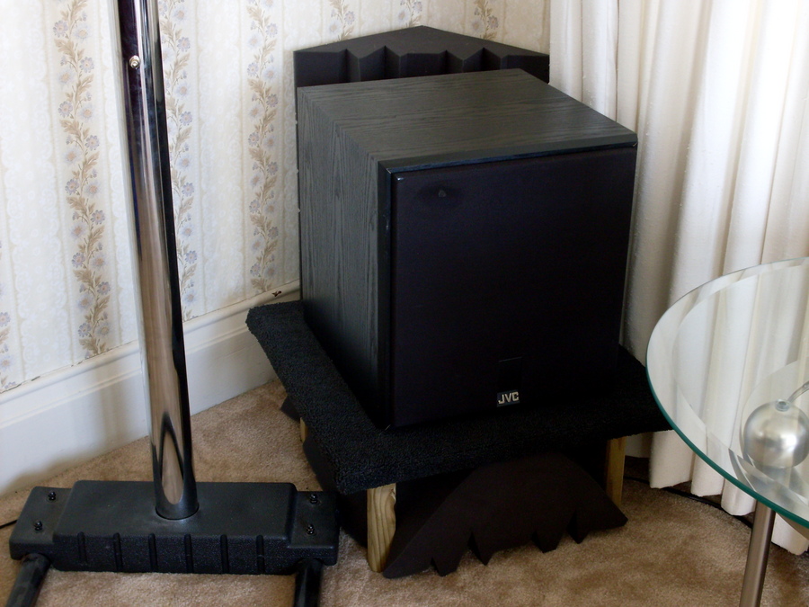

and this is the beautiful thing about my riser, which I'll always call my "GRAMPA", but have put my own twist into. The riser is raised with 6" legs, and not just covered with carpet, but rubberized carpet. So there is your first example of decoupler vs riser. Then I took one of my precious Auralux bass traps, and butchered the living crap out of it to glue it to the bottom of the riser, and setting it just so the bass trap slightly pushes into the ground underneath. With this combination, I believe to have found the perfect subwoofer enhancement for my application. Of course this may not be ideal for everyone, but it's personalized for my taste, and it's results are impressive.
show off! hehehe. seriously, great job on the riser you created.
aramis, ive had a little discussion with JJ actually yesterday about this, and what the main difference from a riser and a decoupler is. heres the bulk of what ive mentioned...
The Grammas from auralex were intended as decouplers and not as risers, with its primary goal is to isolate the amp/subwoofer from the ground further reducing the coupling with the floor and the room.
isolation comes in two forms : decoupling or coupling, you either want the device (which can be a speaker, an amp, a turntable) to either couple (interact) with the room or not.
Decoupling prevents it, or minimizes it at least.
Coupling increases its participation in the room, which is done mostly with speakers, and allows you to have more interaction with it. There are a number of reasons why most people prefer to decouple the speakers, including 'false' gain increases, as well as coloration.
You want to listen to the music, and not the room. - the reasoning behind acoustic treatments.
in regards to risers, with risers you are addressing the room mode. two different things.
decoupling speakers removes the interaction of the speakers, while risers ADDRESS room interaction.
passive acoustics versus active acoustic treatments.
so why dont subwoofer companies not provide such risers? why do we have center speakers that have lobing issues? Why dont speaker companies stuff everything with polyfill? why arent power filters included in each AVR and/or pre/pro?
There can be a number of reasons, but aside from marketing, the one that comes up would be because subwoofers were built to be easier to place.
We've removed the subwoofer, the lower frequencies of most speakers and placed them in a big huge box. aside from aesthetics, i dont see any reason for them to add on huge risers on them to improve performance. Ive also considered that each room has different vertical needs to be addressed, thus no common denominator for a risers height.
As mentioned, we just try small things here and there to help out with our room, but dont necessarily believe them to be the most imperative part of a home theater build. if you're room is acoustically tight, and have the proper placement of each component in the room, then theres no need to address them.
