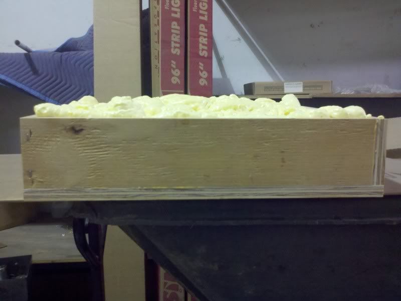

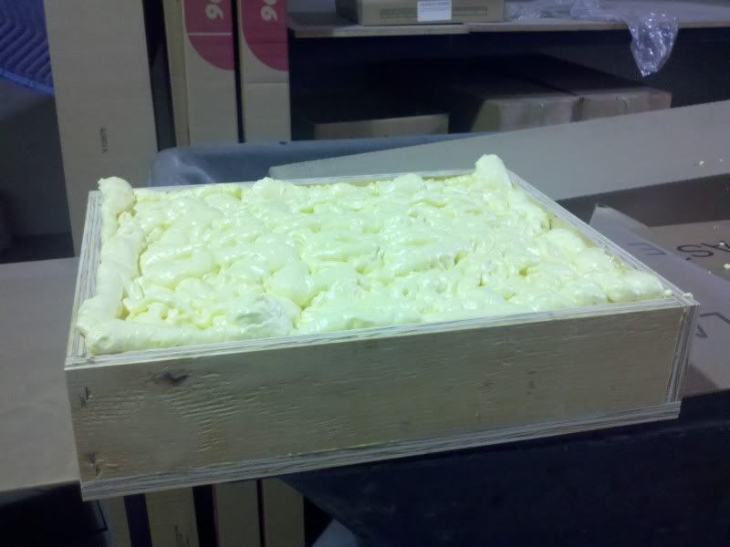

Well i've built most of my risers now. I just need to find some black carpet to cover them with and hopefully get some rubber feet for the bottom.
They are 3/4" thick plywood 16" x 20" x 4" tall. All of this has been free so far since my work has all the materials and scrap to use for free. I used wood glue and pneumatic staple gun to secure everything together.
Here is the interesting part that I don't think anybody has tried yet. We had some window and door insulating foam in a can sitting around. I figured it would work pretty well instead of trying to find some foam pieces to fit the opening underneath. For reference we used 3 full cans and it only filled about 1/2 of the empty space underneath the risers. The stuff expanded to what you see in the pictures overnight. I will be using a hacksaw to saw off the excess that overhangs the bottom.
I will update once I finish them and calibrate them with the new PA-120 sub that should arrive this week.
Great Sub, I have 2 of em'! Looks very good, that is Def Different (expanding foam), hopefully it works the same. Good luck!

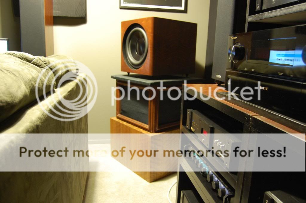

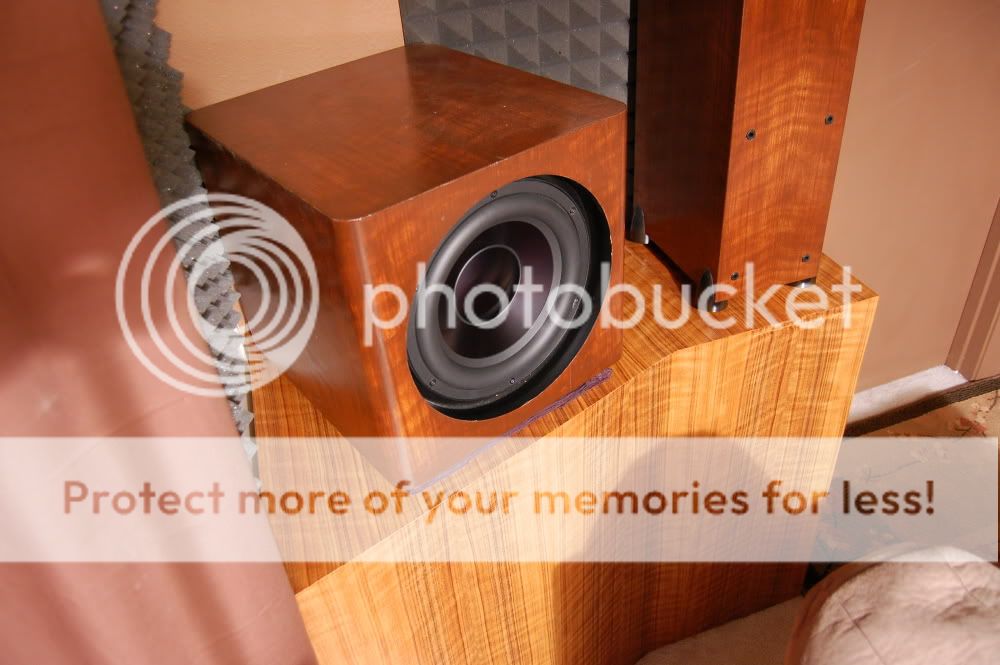

I think being creative & making your own makes it better. DIY I have made all 3 of my risers so they are unique & one of a kind. no one on earth has one like it
I am also a firm believer that the higher the sub the better the sound ~ Just remember I am crazy
Been awhile since I posted these so here are my sub risers.
My 15" sub riser.
My 12" sub riser.
My 10" sub riser.
Old 11-06-2011, 12:34 AM   #1818
spaceape spaceape is offline
spaceape's Avatar
Feb 2011
Denmark
190
My 15" sub riser.
My 12" sub riser.
My 10" sub riser.
They are classy looking Brent.
Did you put anything inside of those subtraps/risers?
