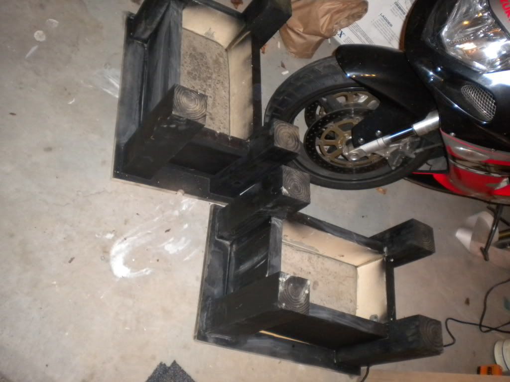

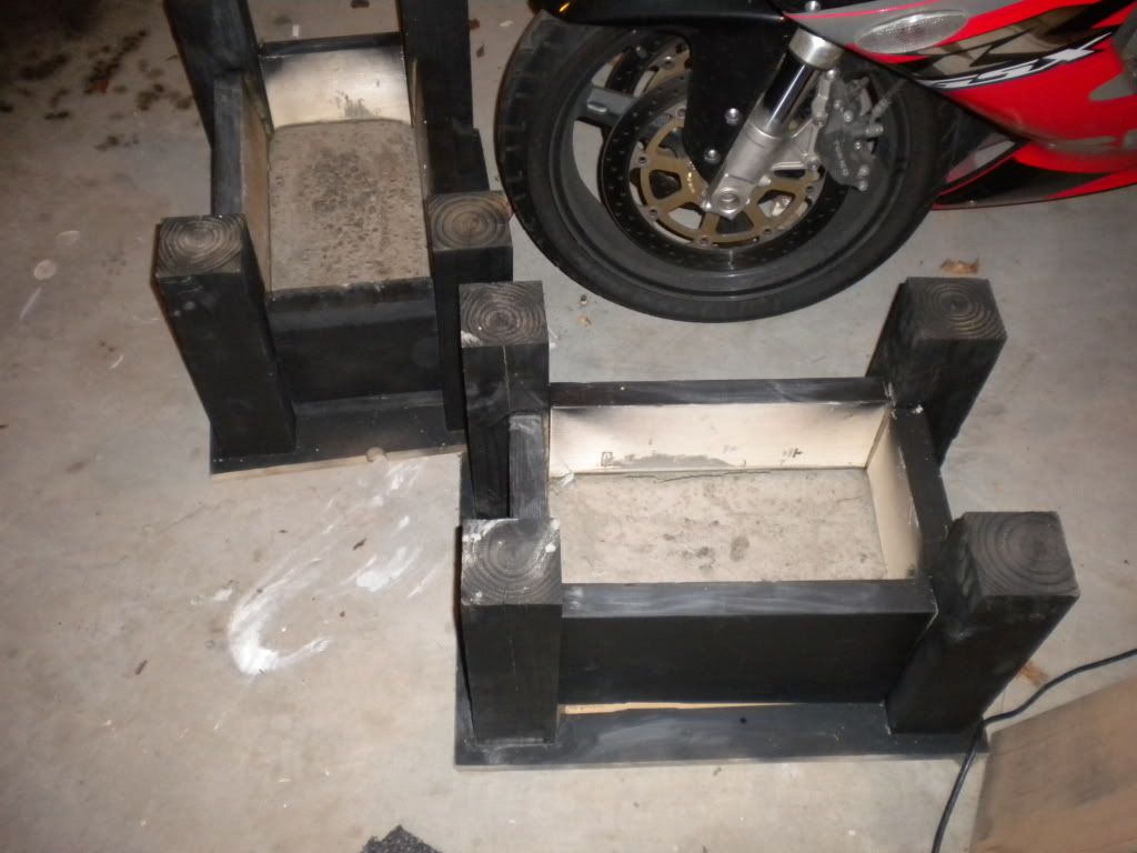

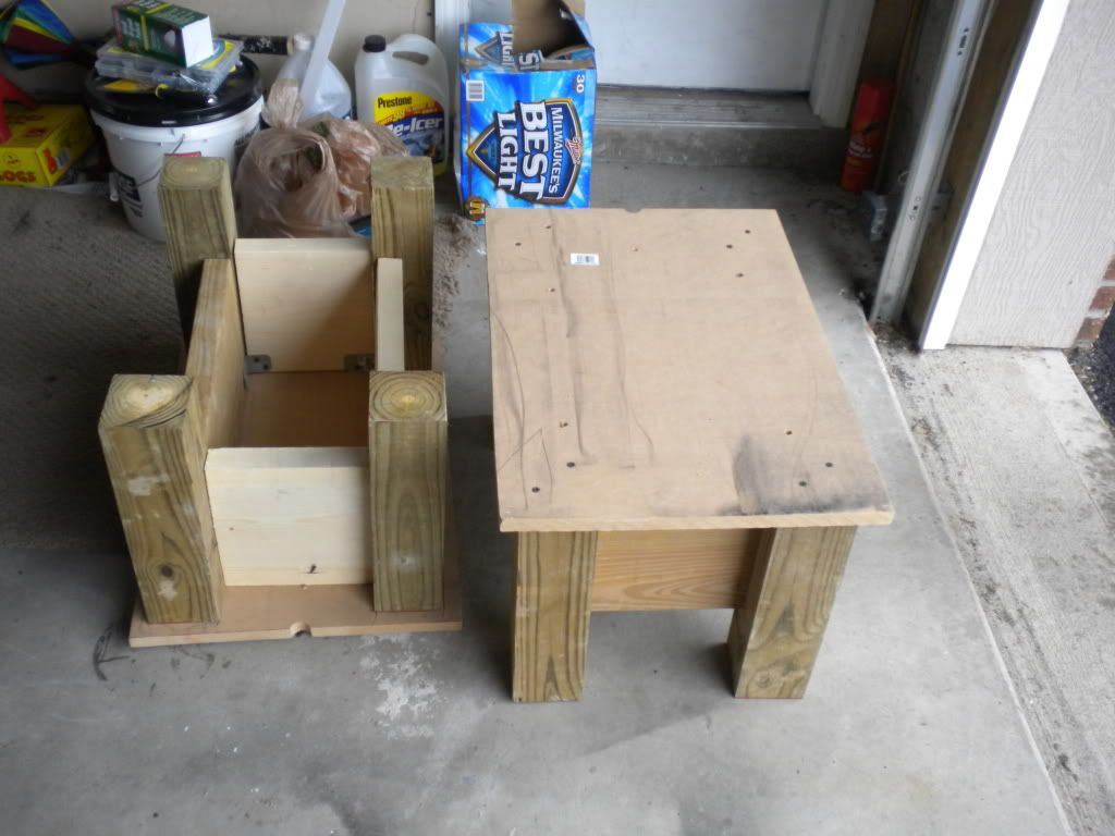

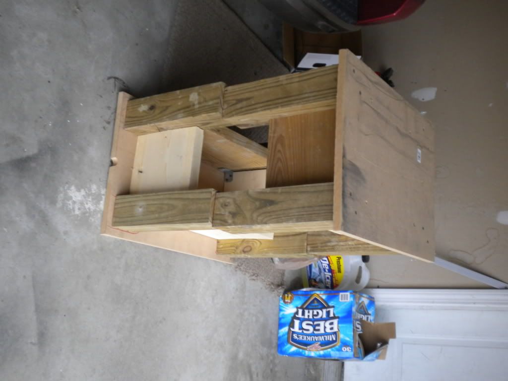

My original intent was to build risers for much larger subs. I had planned on purchasing 2 ed a2-300's, then moved to Outlaw LFM-and ended up with 2 PSW505's. I apologize as I had pics of the initial build but they were lost due to alcohol consumption.
MATERIALS
HOME DEPOT
1-4'X4' MDF $8
1-2X10X8 $7.75
1-4X4X12 $11
12-L-BRACKETS $.58 each
80LBS CONCRETE $1.75 (bag partially torn)
RUBBER BACKED CARPET-scavenged from my ofc remodel
BIG LOTS
4x8 AUTO CARPET $8
RISERS
14"X17"24"-100LBS EACH
RISERS
First coat of spray
Old 01-05-2012, 02:44 AM   #1845
BIG INJUN CHIEF BIG INJUN CHIEF is offline
BIG INJUN CHIEF's Avatar
Nov 2011
Pittsburgh

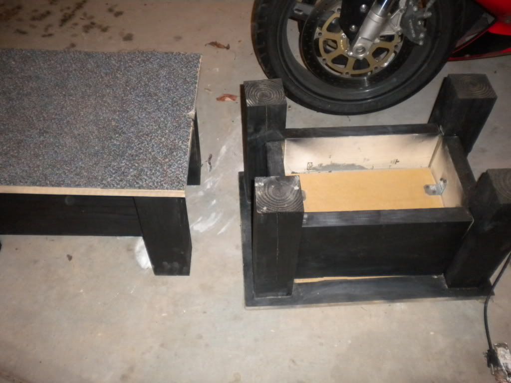

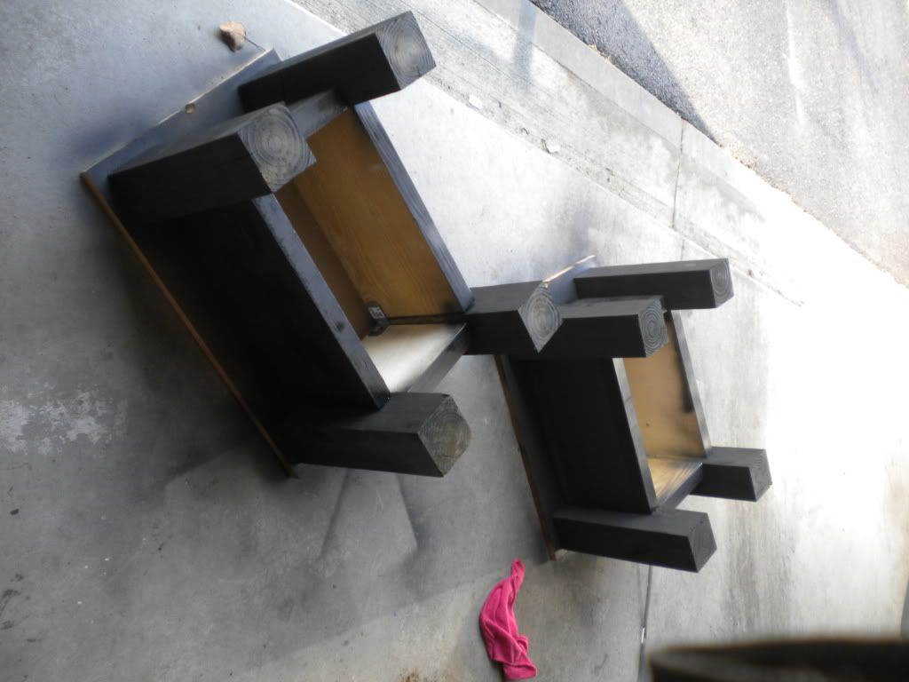

I filled each riser with concrete and this will force a re-spray. Made a bit more of a mess than anticipated.

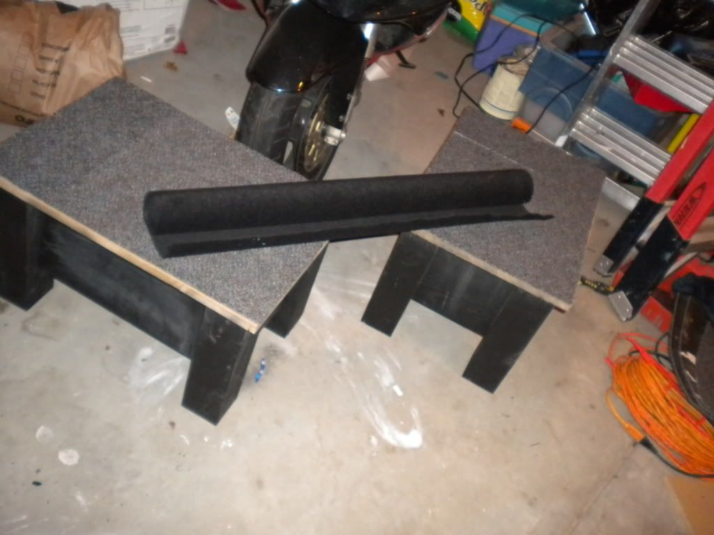

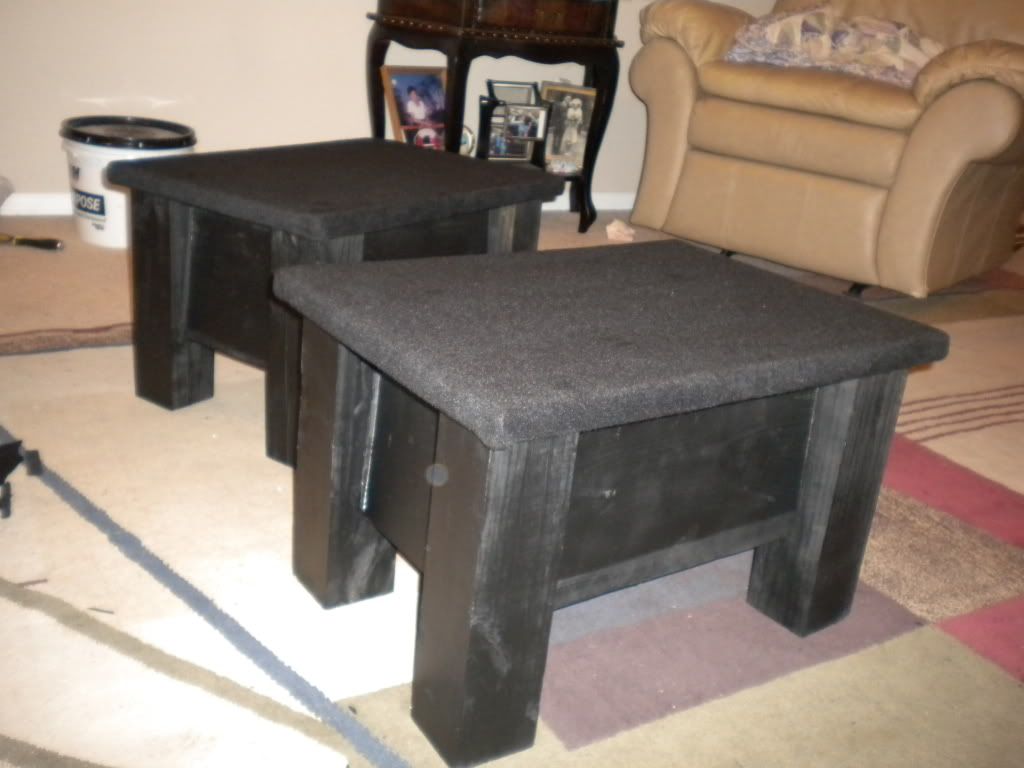

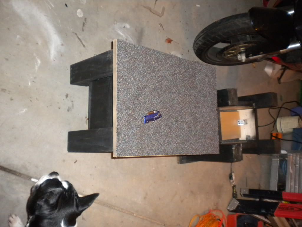

I then placed a few pieces of rubber backed carpet that was scavenged from my office remodel and secured the concrete with a brace.
In addition, I glued rubber backed carpet to the platform. I intend to cover the platform with auto grade carpet. This is were I would like a bit of assistance please. I hope to staple the carpet over the platform. I have never used this or any type of carpet. Would it be wise to also glue the auto carpet in addition to stapling? Please assist. Any comments or suggestions are welcome.
I will also place a few pieces of the carpet on the bottom of each leg.

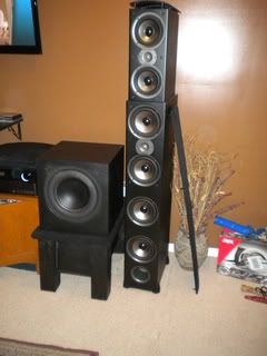

I have finally competed construction and set-up of the riser.
I will violate a personal rule and pull the grills off the PSW505 (ugly driver) only to show I painted the face plate to match (sorta) the polk monitors.
UGLY DRIVER (sounds ok but uggggg'lee).

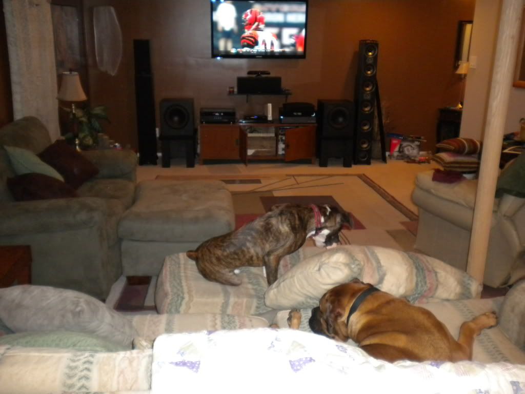

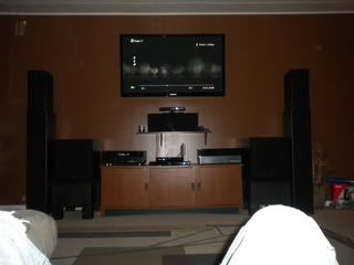

A few additional photos of the entire basement system. I am now off to further educate myself with respect to acoustic treatments and projectors.
. Apologies for the photos as I suspect the lens in the camera is a bit dirty.

The thing is, how does it sound?
Old 01-09-2012, 09:20 PM   #1857
Nov 2011
Pittsburgh
Clean and very tight. I have yet to re-run YPAO, but I did knock a few dbs off from the receiver. For a budget system I am very pleased. Amazing thread!!! I am now researching acoustic treatments and considering a projector. The display is rather small (50") for the space.
