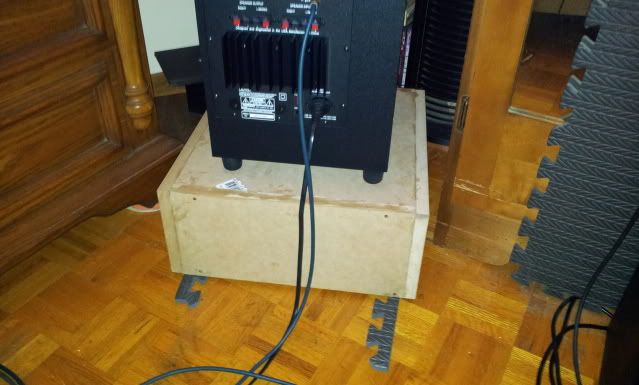

Well i'm almost finished my riser/isolator.I started from scratch with some thick MDF and ready to stuff it with fiberglass.I got two small bags.I guess I should use it all.Or can I put too much?Some guy at home depot suggested putting sand in it also.I'm going to put some foam feet on the bottom and maybe put it on a anti-fatigue mat.And of course I will cover it with either black crushed velvet(which AJCxZO above used,and looks great!) or black carpet.I spent more than I wanted but I think it will be worth it.
Oh dimensions are 7"x15"x15".

As for how much to put inside, I'd say enough that it fills the insides, so the 2 bags should be enough. As for the sand in the bottom, not a bad idea, especially if you feel it will help Stabilize your riser (at 15" high, it's prob a good idea actually).

It's 7" high and 15" by 15" wide.I'm going to test it first thing tomorrow.Two bags of the fiberglass fit perfectly.

No I didn't use sand.But I didn't need it.It definitely works.Had to turn it down because of the gain in dBs.

Well I re-calibrated and did notice the performance improvement. Especially the fact that I can hear the prominent extension of the bass now.Though it could also be burn in.But it definitely isolates the bass more for better sound integration.

Here it is pre-carpet.
