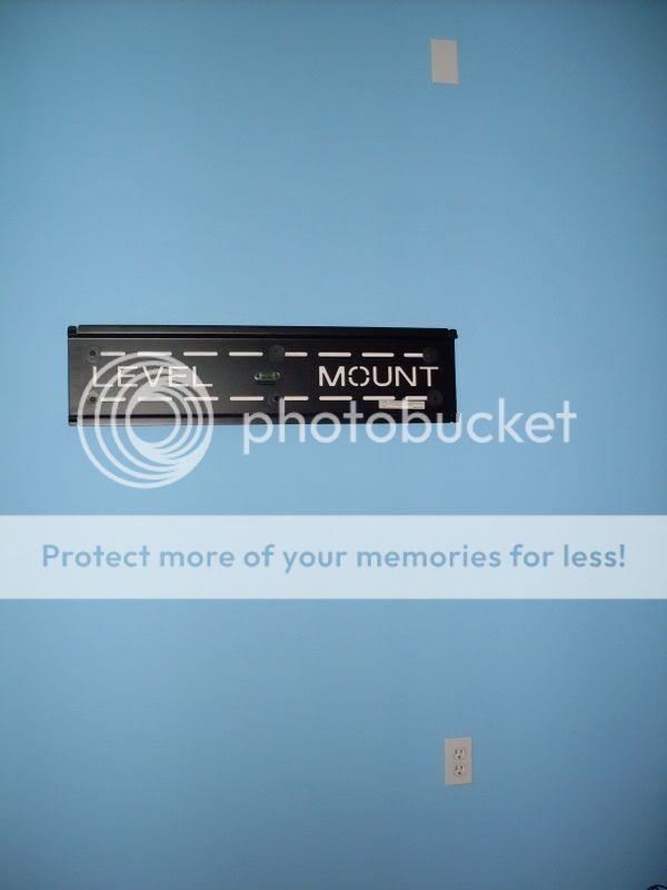

You can use good long screws to mount the bracket to the studs in the wall . Bolts are not necessary ! I have six 4" screws into 3 studs holding the bracket to the wall ! My display has been on the wall for 7-8 months now ! It is vary easy to do , Just make sure you hit the studs !!

39
292
Or if you get a mount like crazyBLUE, the mount will have a level built into it.
