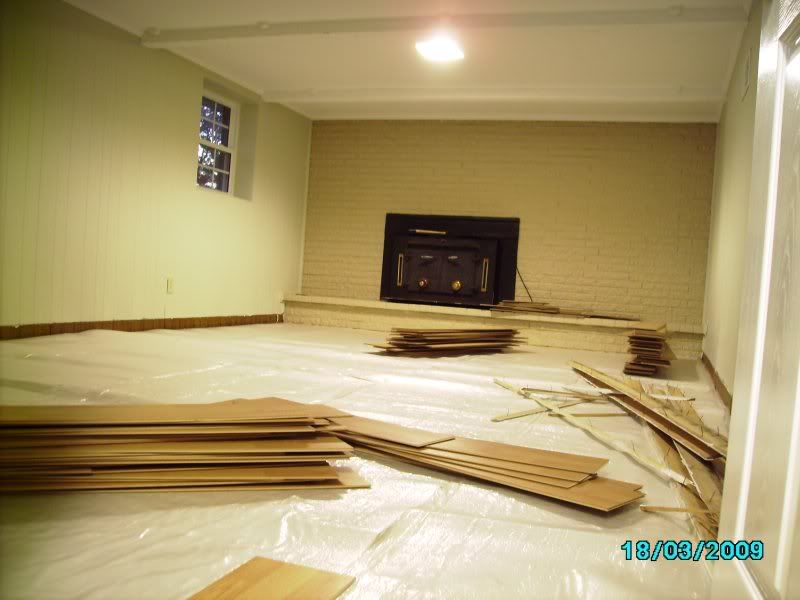

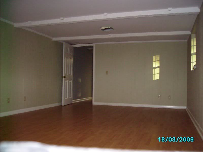

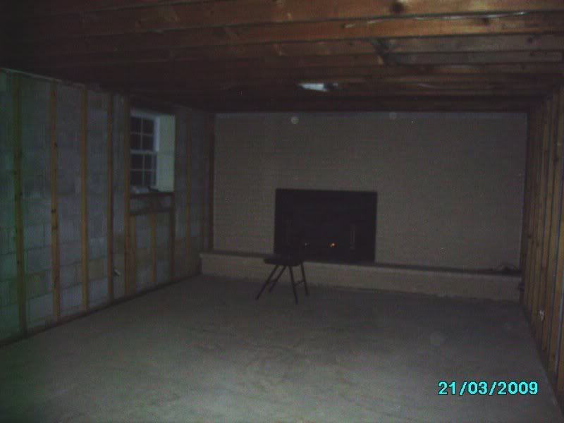

Here is the room before I began demolition:
Back of the room
Front of the room
View of the room from the hallway
Here is the room through and after demolition:
Right after I pulled the floor and molding out

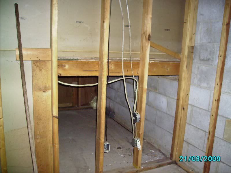

Room entirely gutted, waste removed, and swept/vacuumed. I was too tired to take pictures until this point Trust me it was a MESS.

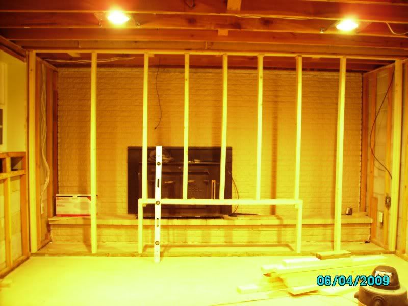

This is a shot of the front theater wall next to the entrance and the adjoining storage closet under the stairs, opposite where the screen wall will be. I plan to cut out the studs to open it up, and install some recessed shelves in the space under the stairs for all of the equipment. I will relocate those outlets under the stairs and have all cabling running behind the wall and into the room under the stairs for a very clean look with no visible wiring anywhere. The shelves will be flush with the finished wall, taking up no space in the theater room and allowing easy access to equipment from within the theater room.

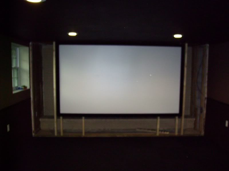

-- Built the false wall
Here are the pictures:

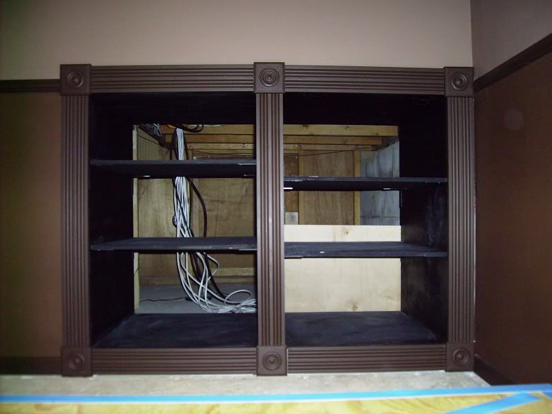

Here are the shelves (mainly) finished and recessed. The only thing left to do is screw the back panels in (you can see them leaning behind the shelves), and cut some holes for the wires to run through. The iffy painting on the sides will be covered up by trim
The completed false wall. I made a measuring mistake, though, and I may have to add 2 studs to be able to support the 120" screen's width.

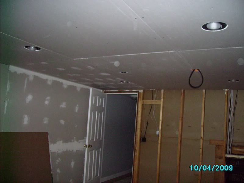

Beginning to drywall, have a few pieces up on the ceiling and one side wall
A better picture of the side wall fully drywalled with some mudding done
A closer look at some beginner hanging/mudding on the side wall
Here is a shot facing the door of the ceiling and one side wall hung

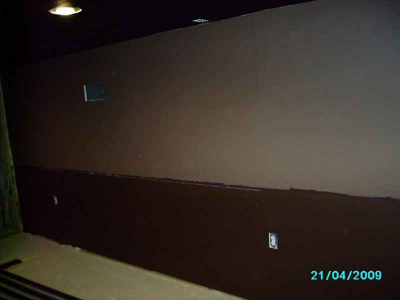

Walls primed (those bare joins will be covered by a chair rail, I got really tired of mudding )
Ceiling painted flat black
First wall color up, it's actually a darker brown than that in person
Second wall color up
Trim painted and ready to be installed

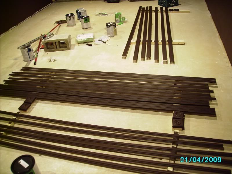

A shot of the 5'x10' sheet of Wilsonart laminate

This is a great picture showing the trim work on the shelves, and the flash illuminated the tangle of cables coming out behind the shelves and some spare wood

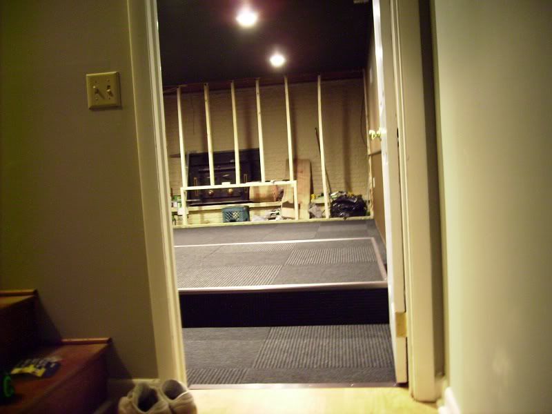

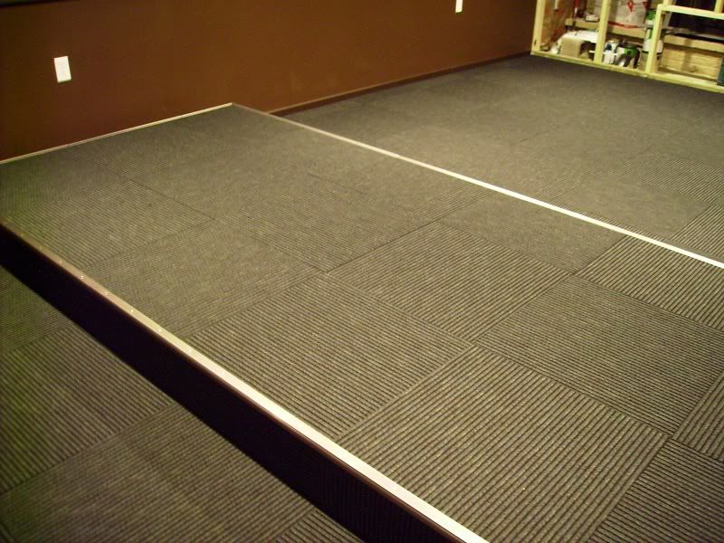

This picture shows the platform beginning to be carpeted, and also shows carpet already laid from the platform to the screen wall.
Another view, also showing some of the wood to be used for the screen, and a better look at the carpet already down on the floor.
A good photo showing the platform in the context of the entire room.

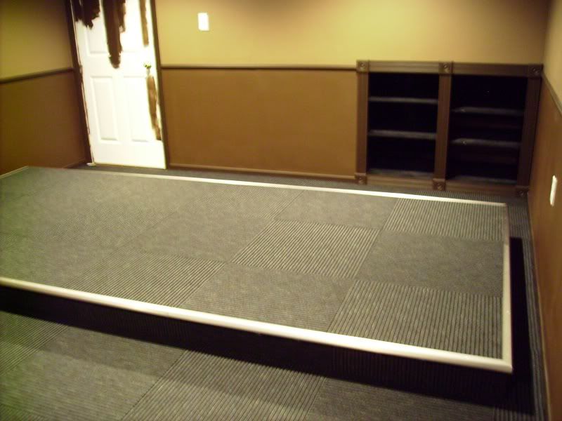

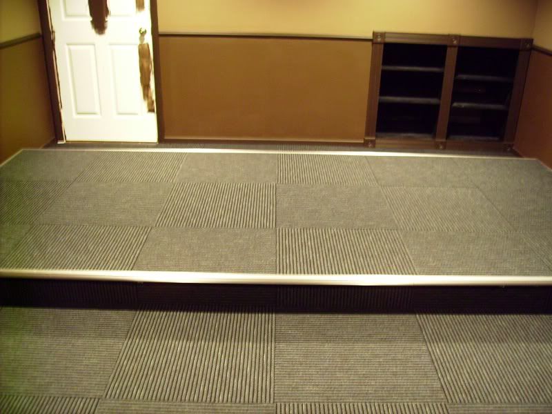

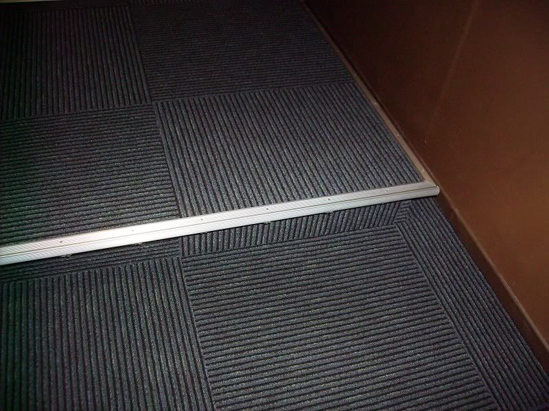

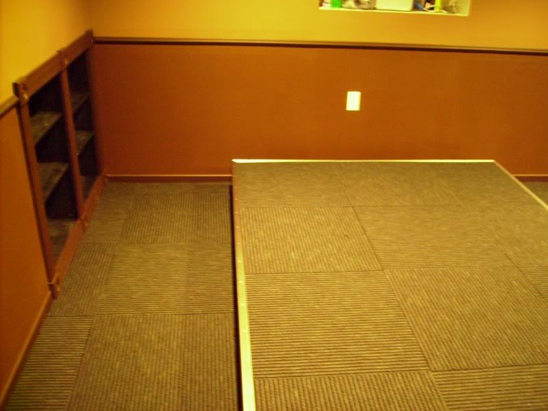

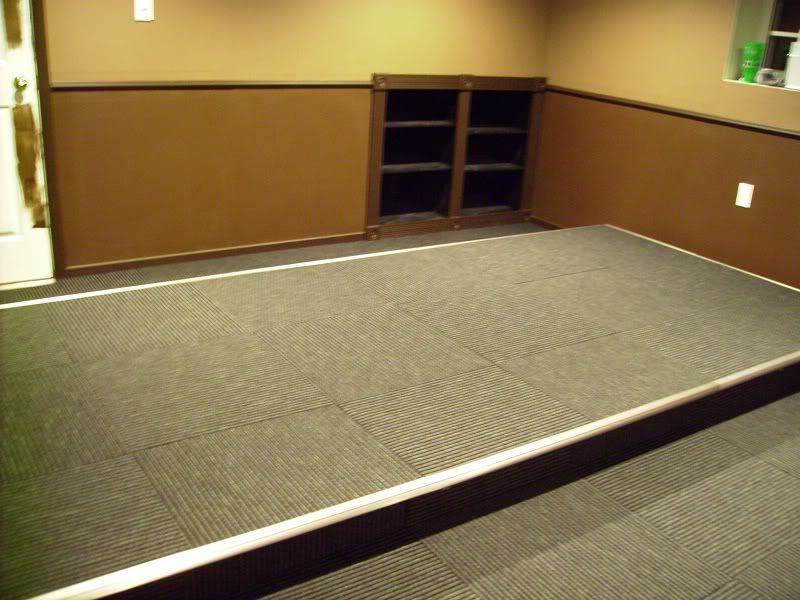

Platform finished, and it and the entire room carpeted. I installed aluminum stair edging around the perimeter of the platform, and mitered the corners.
Another shot of the carpeted platform and room.

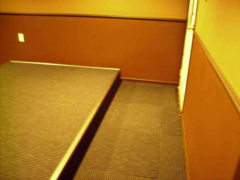

A closeup of the side and mitered edge of one corner of the platform.
Showing the space between the door/wall and the platform.
Looking at the shelves across the platform.
Standing behind the platform looking at the shelves.

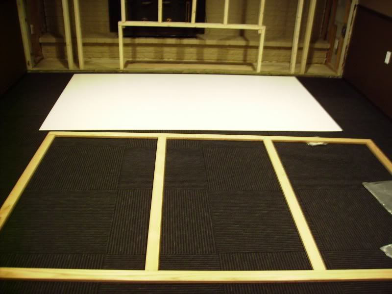

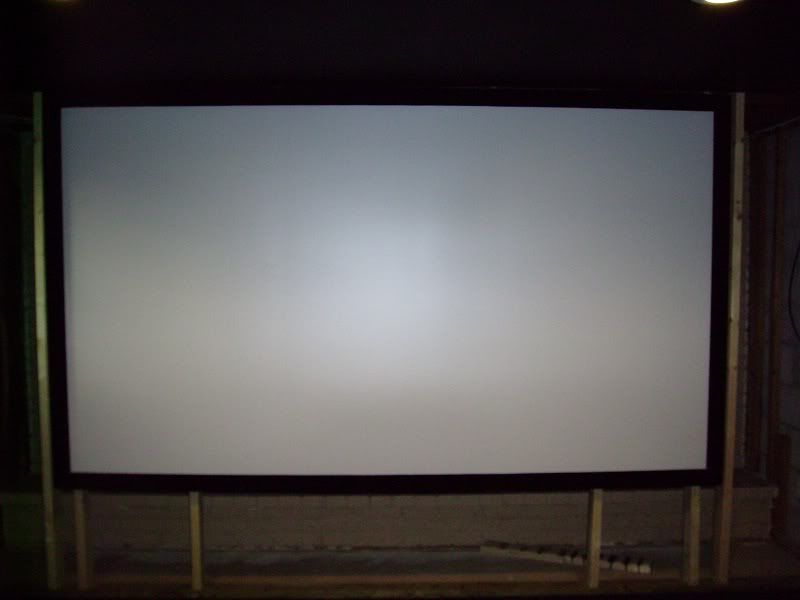

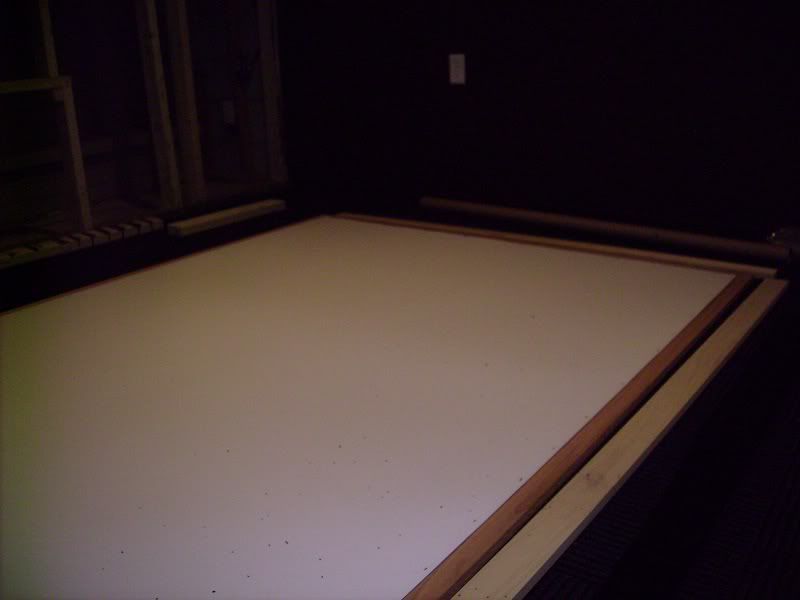

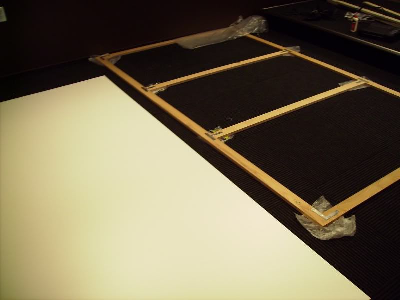

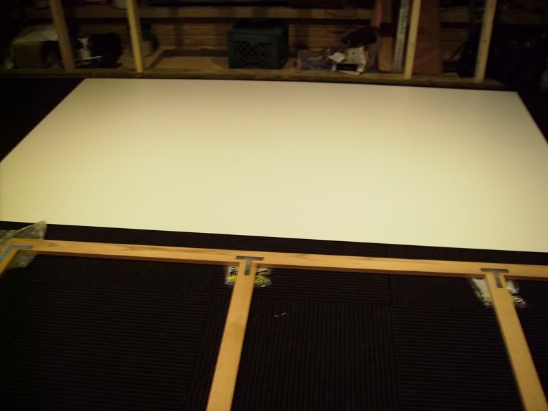

Building the screen frame with glue and brackets. I used oak from a hardwood specialty shop, and I went through the whole lot of 1x3s they had to find the straightest ones.
Another shot, showing more of the laminate, now cut to proper size for the 120" diagonal screen.
Frame flipped over and ready to have laminate attached.
Laminate stapled onto frame, poplar boards laying beside to be used for the velvet border. The plan is to wrap velvet over the poplar, then nail the poplar to the oak frame. The screen will then be mounted to the false wall with screws going through both boards into the studs behind. The velvet will then be pulled around both boards and stapled to the back of the oak frame, leaving the velvet border raised above the screen surface and the GOM-wrapped panels once installed.
I was working so fast I once again neglected to take pictures of what I described above, so we now jump to pictures of the screen finished and already screwed onto the false wall.
Another blurry shot of the finished screen.

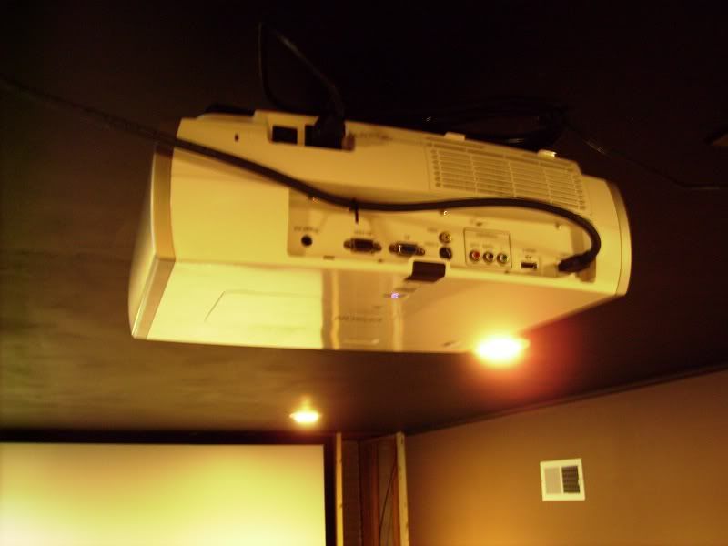

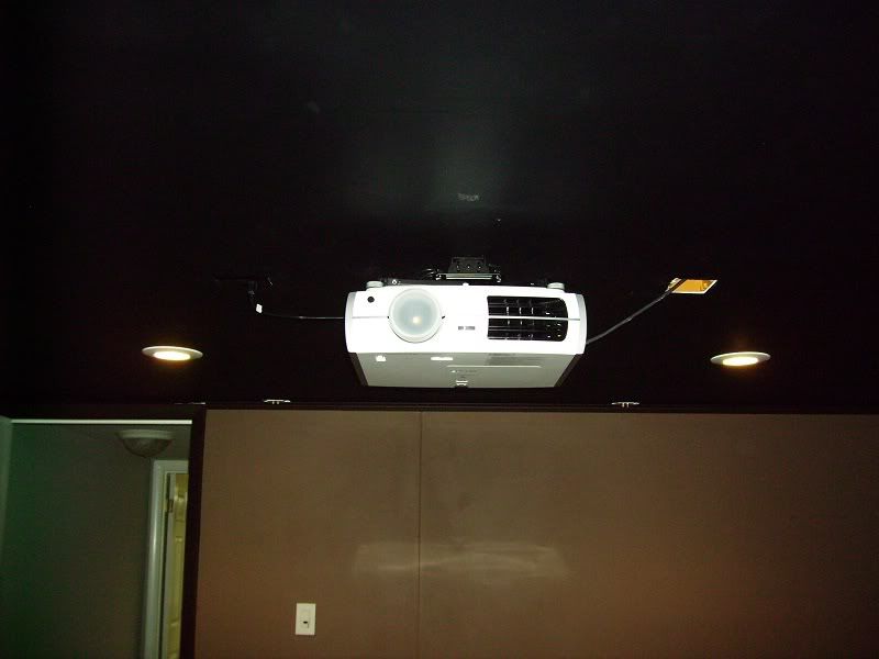

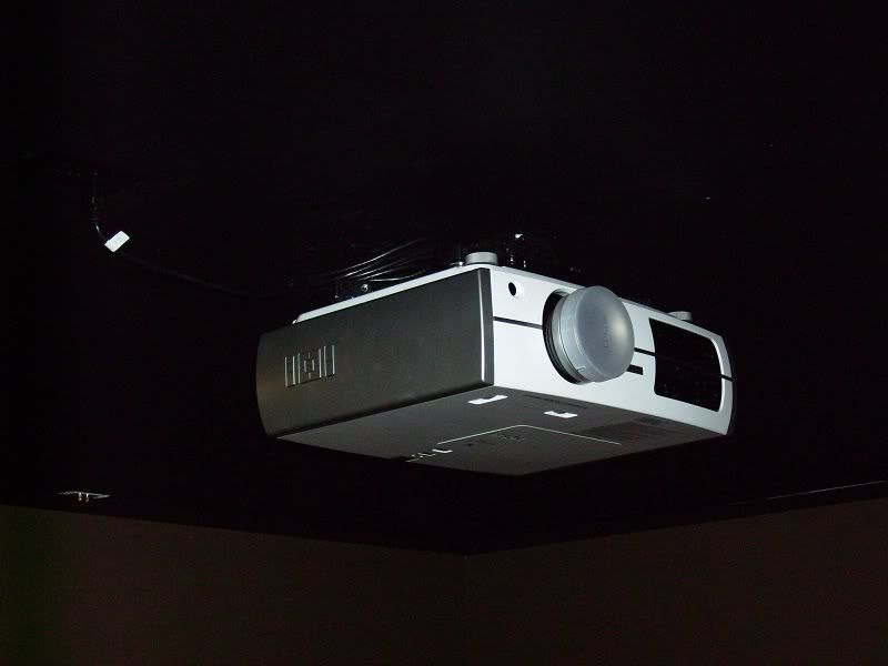

The projector mounted.
Behind the projector, looking at the screen.
Another shot of the projector.

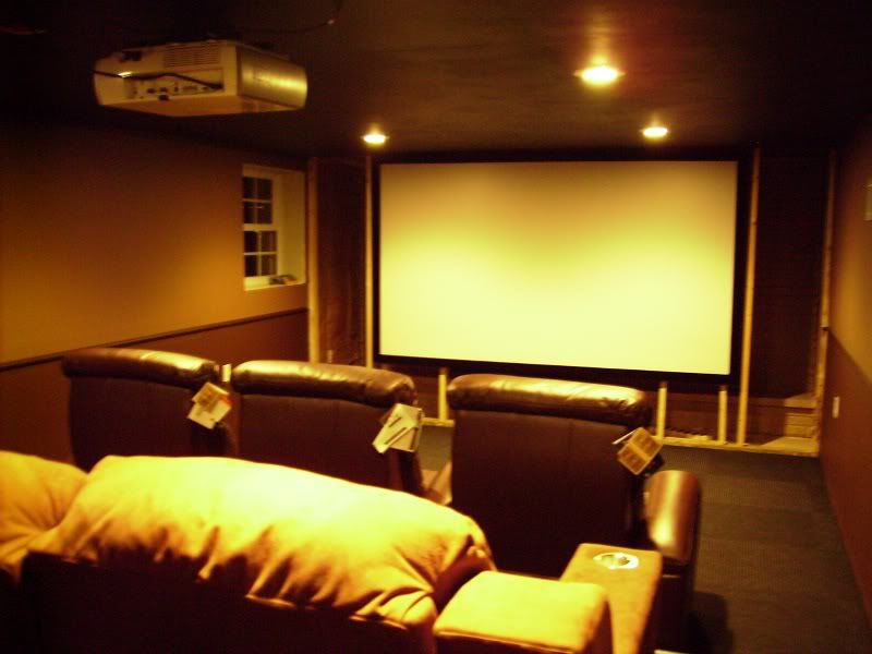

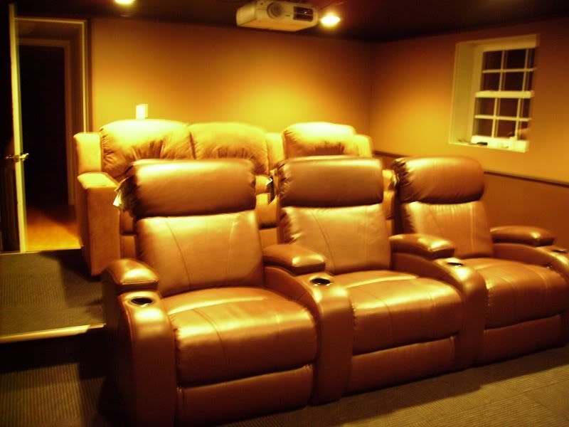

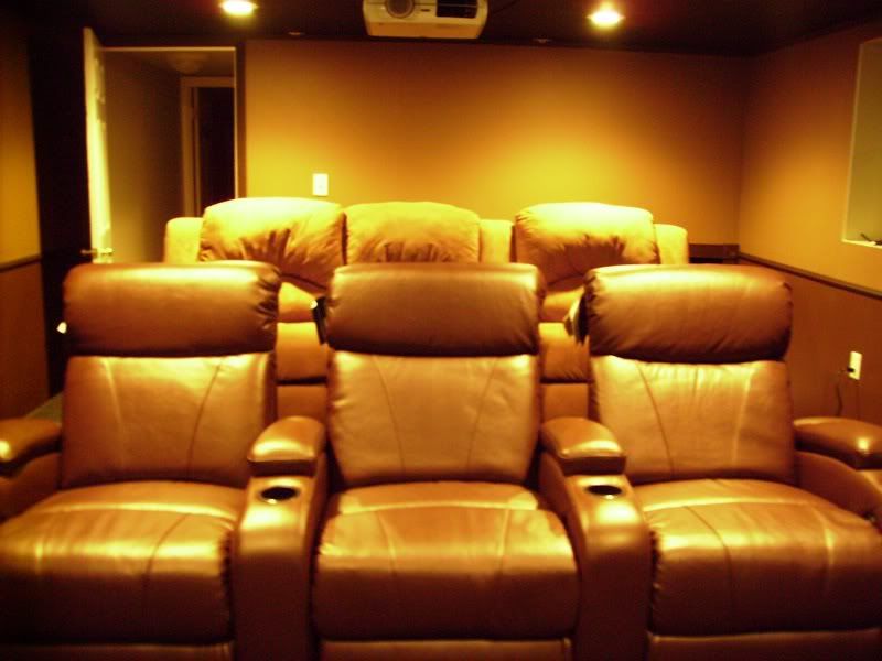

I decided to move the seats in before building the GOM-wrapped panels. The seats closest in the picture are the brand new Berkline 12000s I got in this week. The second row are some no-name (but very well built!) theater seats we already had for our previous living room home theater before we moved into the house.
An interesting story about the Berklines, the truck driver snapped our telephone line with the semi when he was making delivery of these! I wasn't too worried since I don't have a landline, but I called it in since I was sure our neighbors wouldn't be too happy
Looking past the seats to the screen.

-- Finished building and painting the shelves and recessed them in the wall

Looking into the carpeted room from the hallway.
