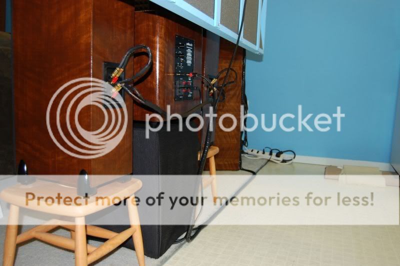

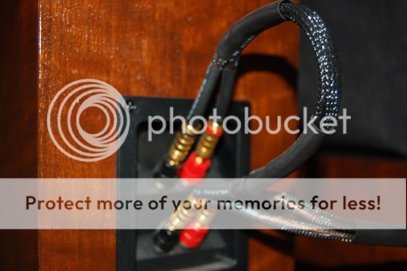

You can do something like this , It will work the same way as the connector plates .

Do you have a closer pic, Crazy?
Edit: NVM you added another pic
No , But I can have one in about 5 minutes if you want !!
Old 11-22-2009, 04:12 AM   #10
Icecoldblue Icecoldblue is offline
Icecoldblue's Avatar
Calgary, AB
If you have time, sure, why not.

Pacific Northwest
89
479
38

Crazy, that must've taken a while to get two wires into one plug. I would've just bought a pair of open screw banana plugs for the bridge, and then shove my regular plugs into that one. But yours is definitely cleaner than that idea.

I learned how to do all this stuff here , So I was glad to help !
Glad I could help Supersix4.
Thats 12AWG wire & although it is big , Both just fit right in the plug
