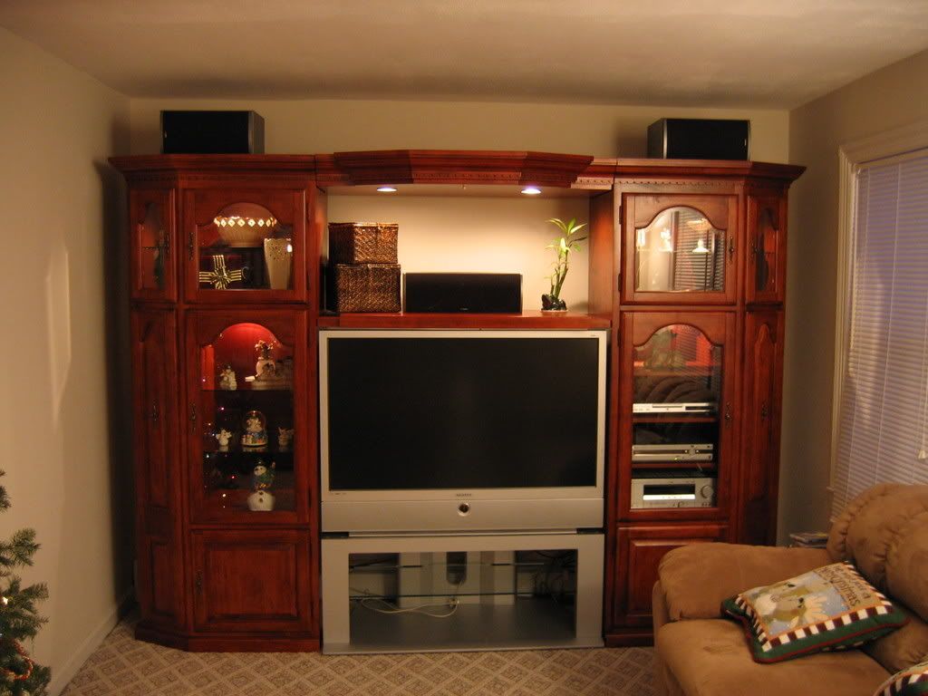

When I first bought my Samsung DLP I had it on a stand alone stand that I you see in the picture. I then bought the wall unit some time later. I hated how the stand clashed with the wall unit

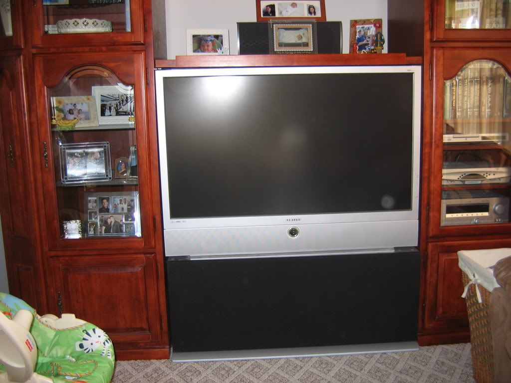

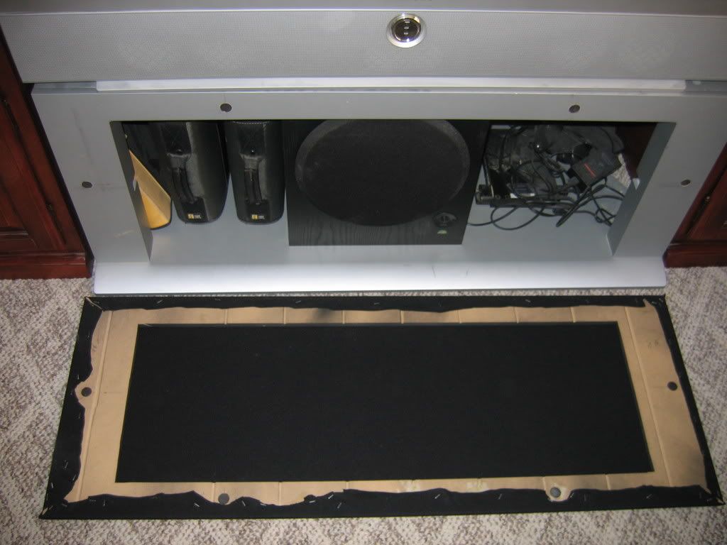

I then decided to remove the glass shelf within the stand and put my Sony Subwoofer with the stand and build some sort of cover for the stand but keep it accessable. Placing the sub in the tv stand was very difficult, I had to take apart the stand, remove the glass and then modify the back of the stand so the sub amp had enough clearance.

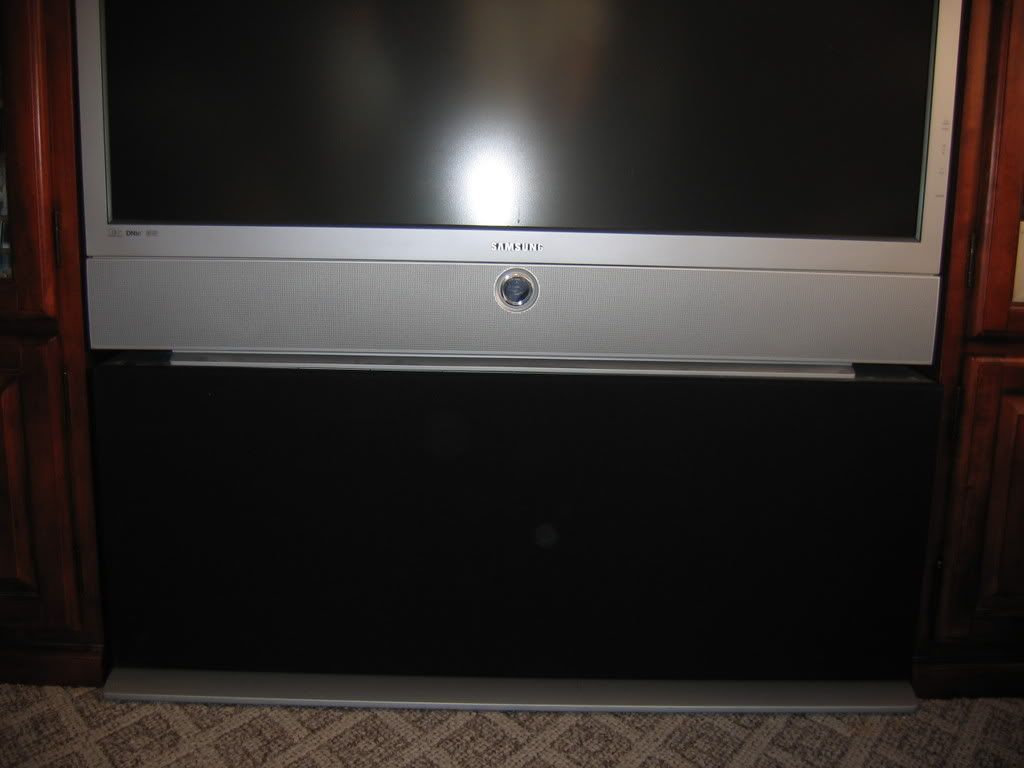

Then I decided to get some scrap MDF and cut out a frame that was the same size as the TV stand. I then went to Home Depot and got some round disc magnets that are very powerful. I countersunk them in the TV stand and in the wood frame. I then covered it with speaker cloth and tada... A completely accessable unit that looks like a big subwoofer. I think it works rather well and thought I would share...
