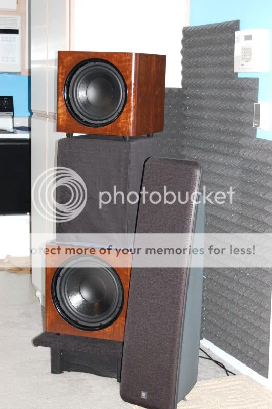

I set up my second sub today and decided to make another isolation/riser for it. I thought outside the box and did something I haven’t seen before. It's two 1/2 MDF with 3" foam sandwiched in between. And those are not the legs, it's just sitting on a table
Attachment 7337
Nice job erict ~ Unique & original !!
I hope it is sturdy enough to hold the sub , is it ?
Why yes it sure is This sub only weighs 30lb and doesn't even compress it at all. It's amazing how stiff it became with six pieces of foam then putting the 1/2 MDF on top. It really helps distribute the weight well. I got an immediate 2db increase and a tighter bass response from it. I put it in the opposite corner behind my over sized chair and really works out well. Both of my subs are out of sight in my room. Just wanted to try something different
way totally cool on the outcome !
Yea I'm pretty satisfied on the outcome. The two different subs blend together well now.
