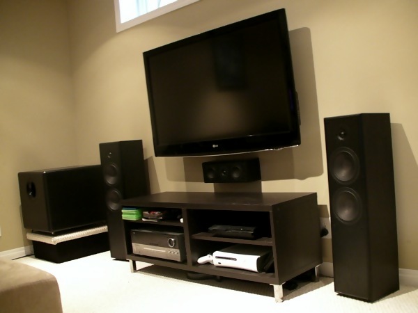

Finished my riser on the weekend, apologies for the bad picture (cell phone camera is all I have). Covered the whole riser in carpet and filled the bottom with foam from a cushion.
Vary nice riser Snpbond ! Looks great .
Now you need to start A gallery for us all to enjoy you setup . From the looks of it you have a nice HT !!
