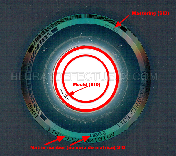

I've only just begin on my rot checking project. I seem to be having a 50-50 failure rate going off the titles in the OP so far. My Punisher BD is bad. I tried really hard using a flashlight and magnifying glass to read mint marks.
All of the numbers are mirror image making it a chore to read. My bad Punisher BD says:
M5 019152.1.A VD08 and 4 tiny numbers LY01 somewhere else.
I can find no other letters or numbers on the inner rings whatsoever. Same with other Lionsgate discs I've checked. The OP says to look for "IFPI" which I have not yet seen on any discs. I don't know how to decode these numbers from the OP and I can't find anything useful with my online search besides a list of SID codes all starting with "IFPI".
Any help or pointers to useful BD mint mark threads would be appreciated. Otherwise I'm not going to be able to share info on the mint marks of my bad discs.
TheIFPI code is the most important to get to know where the disc was pressed and maybe find a pattern...
(thanks to bluraydefectueux.com for the picture)

Thanks for the post and picture. The problem is that none of my BD discs look anything like this. I'm obviously looking at the bottom data side because the top side is artwork.
I'm no good at any type of photography, least of all anything close up, so I doubt I could take a useful picture of what I see other than it doesn't look anything like this picture.
To see anything I have to shine a flashlight and then move the magnifying glass up/down until the letters come in focus. Unlike all the pictures I've seen, the letters on my discs are always backwards (mirror image) and very hard to read. I still only see 1 ring of mint marks and there are no IFPI letters on any disc I've checked (over a dozen now). So I remain stumped. Does it take blacklight or UV or some magical lighting source to make the other numbers visible?

No problem.
It's engraved inside the little piece of plastic in the center of every Blu-ray discs.
It's so little and so difficult to spot that you'll need a direct light and probably a magnifying glass to spot it, yes.
And it should be 3 letters and 1 number or most probably 2 letters and 2 numbers.
As it's clear plastic, you can look for it with the data side up or the artwork up. It doesn't matter as long as you can spot it and it's not backwards, of course.

Thanks. With your additional info I was finally able to find some IFPI numbers. They are on the innermost plastic ring and visible from either side, as you said. However, the IFPI numbers look nothing like the pictures I've seen (such as the one above). They are etched and not inked so you can only see them when you hold the flashlight at a very specific angle. Even now there are some BDs I still can't see the IFPI numbers. IFPI numbers are what I'd call semi invisible and non-trivial to see. I need to get a brighter flashlight.
