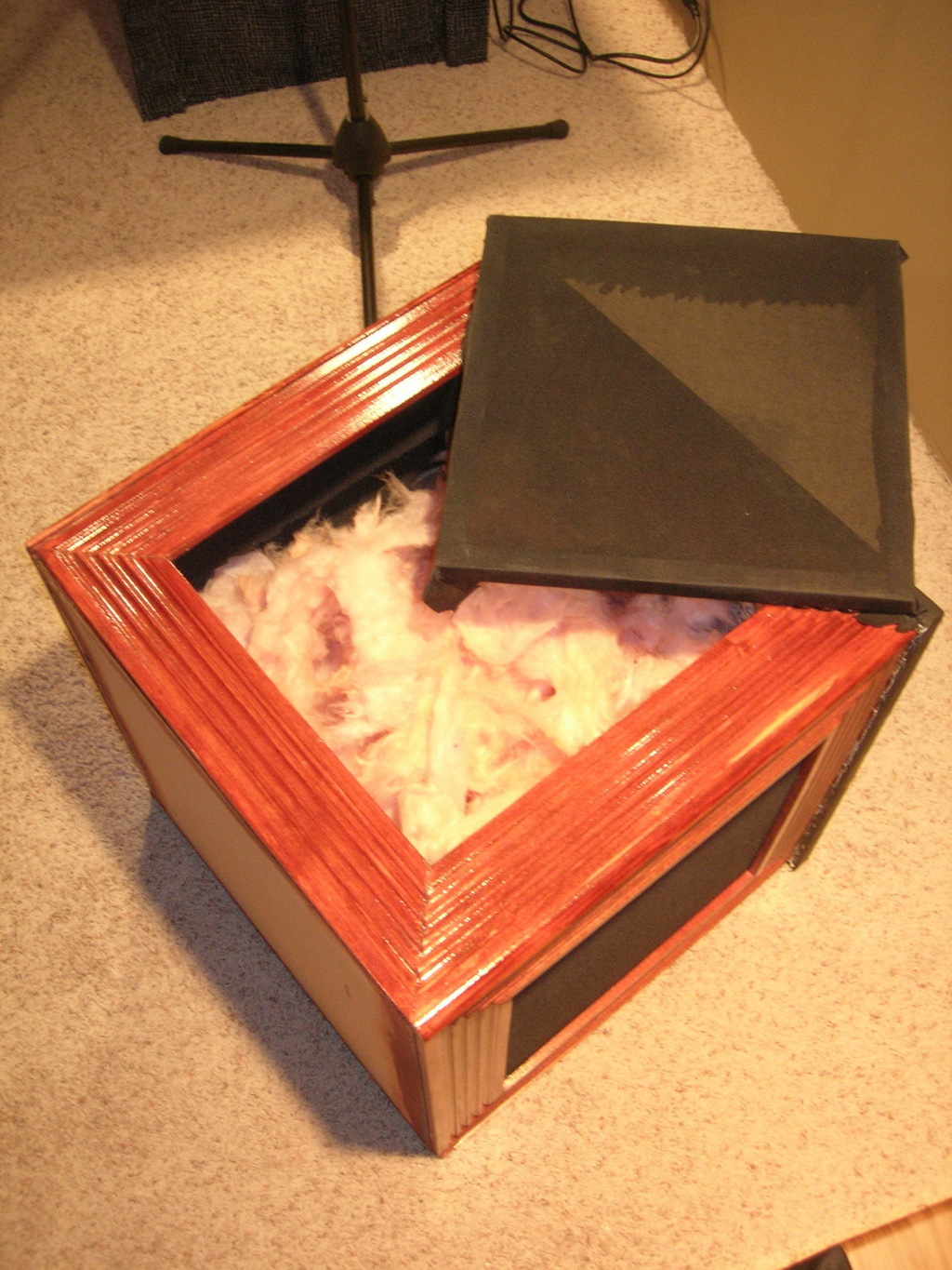

It's built, filled, sanded and I just applied the first side of stain. I'm going to clean the house up and see if I can't find the camera. I decided to go with a simple moulding for the riser, not quite as ostentatious as Crazy's. I even rebuilt the frame for them. I'm making them a little smaller this time, I was testing the old riser out and I think I brought it up a couple inches too far. I'm going to use some left over stain I have from my speakers, see how it turns out. I'll likely use the same clear coat for a protective finish as well. Thanks again crazy for the idea, so far it's turned out great.
The simple design I went with:

Clear coat is done, top is on. I should be able to finish it all tomorrow. I just need to apply the dampening foam to the top and bottom of the riser, build the screens with the speaker grill cloth and fill the space with low density fiber glass.
I'm planing to repaint my subs soon, I think they'll look really nice once they match the stands.

Woo, all done. (aside from the rubber feet which I have yet to order)
Now all I need to do is build another & paint both of the subs
Turned out Great Kareface !
How tall is it , & I like the idea of using the speaker grill to cover the openings !
Old 03-22-2010, 11:07 AM   #1280
kareface kareface is offline
kareface's Avatar
Jul 2009
Seattle, Wa
159
A little over 20", I'm too lazy to go measure right now, lol. You don't have to use speaker grill cloth, anything that you can breathe easily through is sufficient. Just make sure to fill the space with the lowest density fiberglass you can. If you can't use a tuned resonator or a pressure dampening system, the best thing you can do for LF seems to be low density fiberglass. I'm planing to thoroughly test several solutions this summer.
