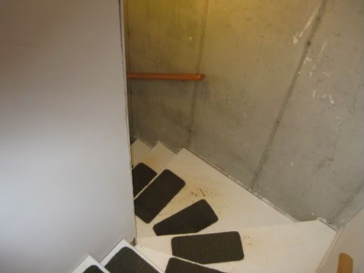

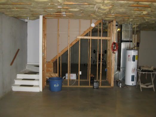

2537
67
Hello,
My basement has no drian and no sump pump.
Concrete is rough. I would not skip the sub-floor. It's not very expensive or hard to install. I also wouldn't put hard wood in a HT but that's just because it seems like it would cause audio problems.
Of course... You gotta do it your way and that's fine. I can't imagine skipping the subfloor though. It's like it goes from being a swimming pool without water (only rougher) to being a normal living space.
EDIT- I can't see your pics. I think my web-filter in installed for the kidz is scared. I'll have to see if I can find some way to force it to trust ya.
