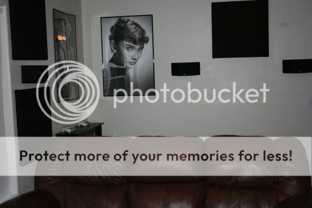

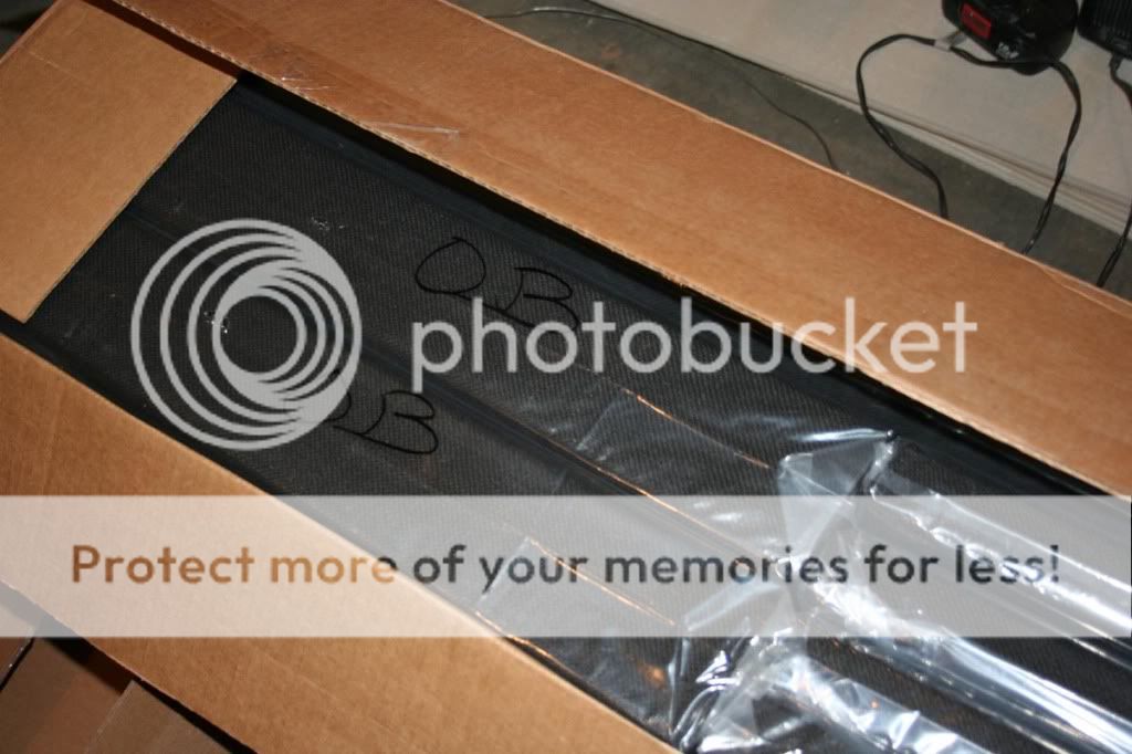

Check out ATS Acoustics. www.atsacoustics.com
I just put tile flooring in and I believe it has helped out a ton. They also have a free shipping deal going on. Good product and fairly reasonable.
Here are a few pics....
Let me know if you have any questions or need more pics!
