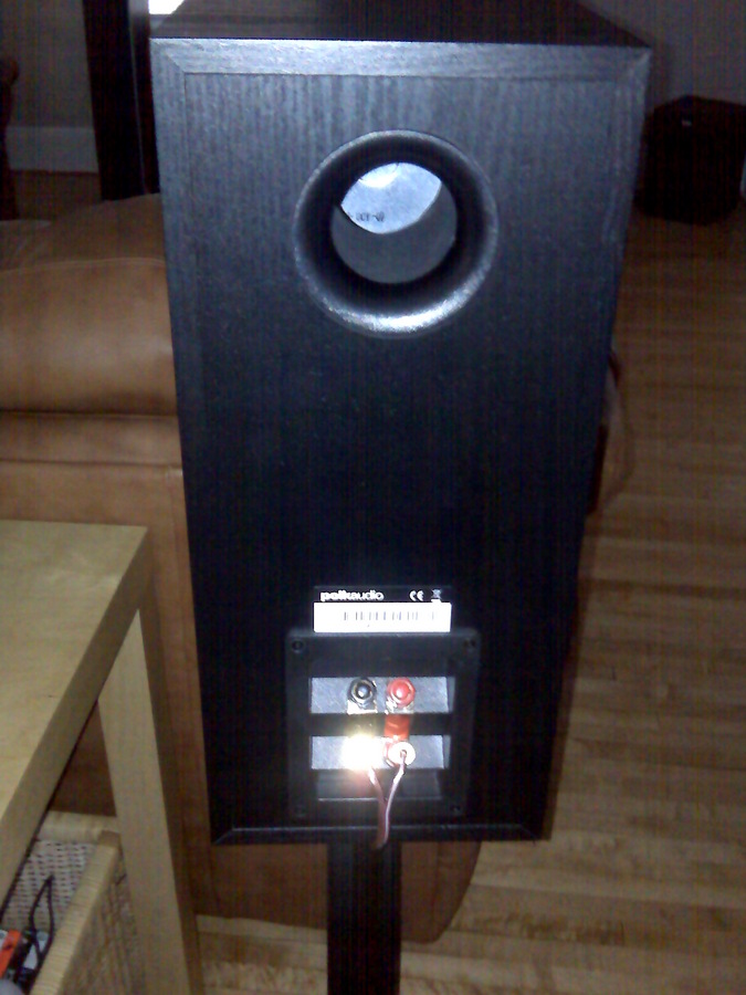

If your speaker has two sets of positive/negative connections, it's for bi-amping/wiring. There should be two metal shims connecting the two sets of terminals to each other- negative to negative, positive to positive. You can honestly use either set of connections.
If you have this type of connection on your fronts, you can use the surround back connections to bi-amp, sending discrete highs and lows individually. Just make sure you check your manual and remove the shims before you do that.
Don't do it on the center as the 606 isn't set up to do that.
*edit* Here's an example:
If you were bi-amping, you'd hook up speaker wire to the top set as well, removing the metal shims. These are my surrounds so I'm not doing that.
