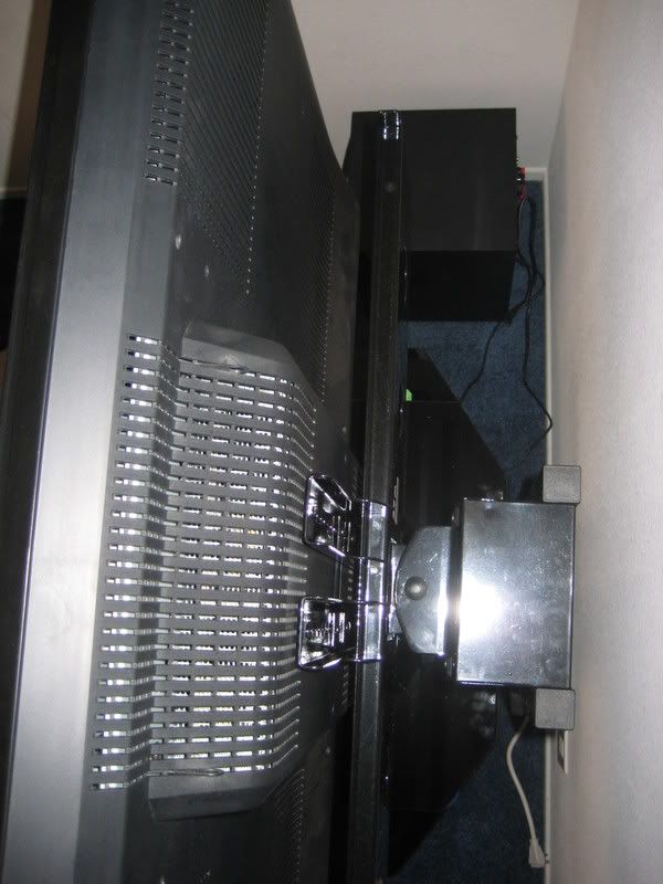

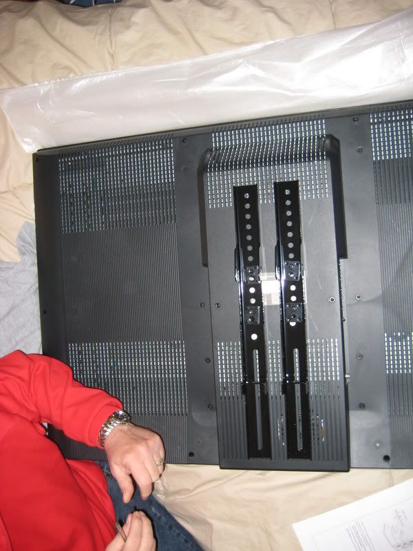

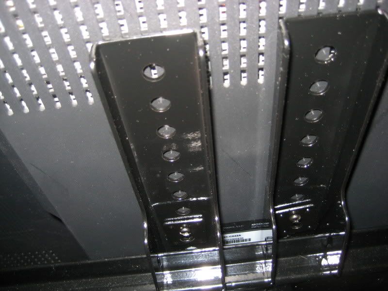

Default Is my TV mounted properly (Pics included)?
I mounted my TV according to the stands instructions and I am a little uneasy with the way it is. Did I not do something correctly or am I just worried too much?
The holes in the back of the tv are really close together which makes the 2 bars holding the TV supporting it are just an inch or two apart. I would think they should be spread out more giving it stronger stability.
Here are the pics:

wrong holes... or wrong bracket
check for holes approx 4" from side
they may have put the screws into the holes already
took better look at pic. looks like your tv doesn't support VESA mounting standard
what does the manual say ??

I have 2 sets, and one close together like that, I too was concerned when I first put it up, but it has been that way for 15 month.
I don't have holes on the side 4" from the ends. As you can see, my TV is flat, except in the middle where it boxes out (which is flat). In this box on the middle (where the brackets are placed in the photos) is a butterfly/cross looking area with screw holes. Then just outside the box area in the center is a line of screws going vertical, but these are a good half an inch subset from the back of the unit.
Installation Options
8 Hole Pattern
75mm x 75mm VESA® Pattern
100mm x 100mm VESA® Pattern wall mounts
http://www.westinghousedigital.com/d...mnum=125#VALUE

It looks like the TV ( what is it ? ) is non- VESA
and requires a special modifier plate / bracket

you're quick !! 100x100 VESA is for a small set, and not the bracket you have

the plate, SHOULD, give more stability..
but if the TV is light, and I guess it is... to be VESA 100
and you are confortable, go with what you have
is it right... no, will it work.... sure

naw..... that's yet another type of bracket. very low profile
because you already have it up... just leave it
If you look at the ones for VESA 100, they are much cheaper, and smaller
just don't let the kids in the block hang on it...

Yikes.
I can't help but cringe at the thought of this setup in my house... and I don't have any children around! Hell, my equipment stand keeps everyone at least 3 feet away from the wall at all times and that mount would still make me cringe anytime somebody walked anywhere in the room.

Here is what the manual says (it's the only thing the manual discusses about mounting.):
The TV has been fitted with two sets of VESA
mounting holes. The holes are spaced 75
mm and 100 mm equally apart for the 42”
product and 100 mm and 200 mm equally
apart for the 47” product. These mounting
location are provided strictly as an option to
the user for wall mounting.
It is the responsibility of the user to use a UL
Listed Wall Mount Unit rated to support the
weight of this TV. Please consult authorized
service personnel for the installation of this
Unit. Incomplete or inadequate mounting of
the unit to the wall may cause it to fall down, resulting in potentially serious injury.

LMAO!!!
I can't believe it!!!
I just realized now that this photo was taken from DIRECTLY ABOVE THE TV! This whole time I kept referencing this pic and swore that it was a side shot. A side profile shot would indicate a wall mount as it doesn't appear to have any support bar heading towards "the floor." An above view reveals a totally different situation since you can't see the support bar anyways.
P.S. I had wondered why you had a subwoofer mounted to the ceiling. That obviously is not the case! Wow... I feel like dying my hair blonde and changing my name to Elle.
So, I am sorry for all of the unnecessary banter. I'd be satisfied with that situation. Being mounted on that, the TV has, what I like to call, "Earthquake stability." That means that if someone bumps into it, it has room to shake off the ensuing forces. Mounted on the wall with that bracket system, I'd fear that the ensuing force would be shoved into (what I thought was) the one small block where I thought the TV mount brackets connected to.
