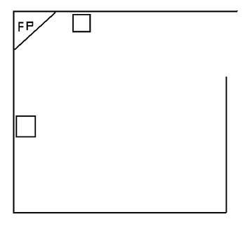

Hi BD. I have a PA 120 sub with a second one on order that should be here by Friday or the Tuesday after Labor Day weekend.
Your placement guide has caused me to reconsider what I intend to do. The only locations I can place the subs are in the middle of the front wall and in the middle of the left side wall. The left corner is occupied by a corner style fireplace. The right corner of the room is about another 15 - 20 feet away and is actually in the dinning room, so that corner is out of the question too. I can only get one sub in the front, next to the right front speaker. My room is 30 x 20 x 15 (vaulted ceilings).
Will I end up with a weird bass response by placing the subs thisway, one in the left side middle and the other in the front middle?
The PA 120's have a variable phase control from 0 to 180 deg. Will I need to adjust that as well?
Would I just be better off stacking one sub on the other in the front middle?
Since you have no pics or diagrams, that's gonna be hard for BD to address. The available positions sound like they look like this.
If so, those sound like good spots. BUT, I don't think that anyone, including BD, can tell you that they will sound good there. You're gonna have to experiment with the positions yourself. You said your room is 30x20, that's a pretty big room. There may be some other spots that you can fit them in there, just don't put the subs right up against a wall. Leave a foot or so in between, otherwise the subs can sound too boomy or muddy.
I probably wouldn't do that. Part of the point of having 2 subs is that you can space them out around the room and the room will have uniform, smooth bass. If there are any dead spots around the room, especially a seating position that isn't against or near a wall, having 2 subs can help hit those spots. Check out BD's post on positioning. Having them across from each other is optimal
https://forum.blu-ray.com/showpost.p...68&postcount=2

Your diagram shows the right idea, but off a little bit. The sub on the left side wall is about 1 - 2 ft from the corner FP. The other sub along the
front wall is about 9 ft from the corner FP. You sort have drawn the reverse placement diagram. The couch is about 2/3 of the way to the back wall from the front wall.
I was questioning whether or not that is preferred or favored position. If not, would the bass thus be lacking or too much in general terms. Just like in the sense that if you put a sub in a corner, it will tend to sound louder and probably boomier. I was looking for qualifying words in a similar sense for the position where I'll have may subs positioned. My reasoning was that if a sub in the corner is bassy and boomy, then a sub in the middle of a wall might be the opposite: lacking bass and thin. That was my main concern, in words as such describing what might tend to happen.
I might be able to just squeeze in a foot distance from the wall to the subs, but will probably be slightly less. This is a living room and not a real HT room. A big box that far from the wall just won't get my wife's approval. The same goes for my tower speakers. The surrounds are mounted right on the walls.
Tbizzle thanks for taking the time to make that diagram. I'm at work tonight and thus unable to make any diagrams like that.
Haha no problem man. As for the sub on the wall, I think it should sound as good as if it was in a corner. It might seem to have a little less output than a corner, but not necessarily. Subs generally don't sound boomy by being in a corner, it's when they're too close to the wall that it can get boomy or muddy.
LFE waves like to interact with walls, so a sub should be placed near one as opposed to in the middle of a room. At least that's my understanding of it, I'll let the pros chime in on this stuff though [edit: BD swooped in while I was in the bathroom ]. I'm just speaking from personal experience I've had with this stuff in the last year and from with what I've learned here on the forums.

BD, those diagrams are just fantastic and that's an understatement actually.
I have an idea of what I can expect in a qualitative sense. It looks like my arrangement will be a hybrid between good and best.
You read my mind when you said putting them in other positions might run the risk of phase cancellation. That's what I was concerned about.
Well, I do have some bass heavy music that might do the trick. If I detect phase cancellation, I'll use the variable phase control on my subs and watch what happens on my SPL meter. BD, that was an excellent suggestion.
