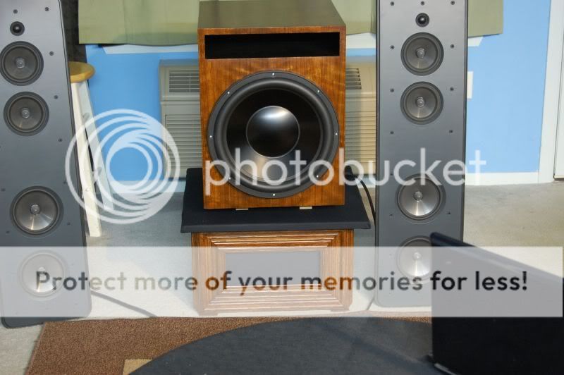

I see you have an amp to drive it so my suggestion is A DIY sub . You can get A pre-made cabinet & order A Driver for it & have it Passive so it runs off one of the channels of your Emo . It will sound better & with the right Driver be better than many subs you can get from A manufacturer .
If this interests you I can give you some links .
This is my DIY sub. It has A 15" Dayton Aluminum Driver . It goes down to 18 Hz & I have it running off one channel of my XPA-5 . I also have A 10" DIY with A Dayton Diver that goes down to 22 Hz I run off the same amp .
For the money you can't really beat a nice DIY, lol. A 15" titanic with the 500w Dayton or bash amp, some acoustic foam and a sheet of MDF would be a little over $500. You'd have a 15" driver & 500 watt amp, which blows away anything in the price range and you'd almost come in on budget. If you made a ported version tuned to 18hz with a 10^3ft enclosure you'd easily be hitting below 20hz with the PEQ on the Dayton amp. Compare that to anything else for $530, it's a joke. But he'd have to have a saw, a router and come clamps, or be able to borrow them for a weekend.
